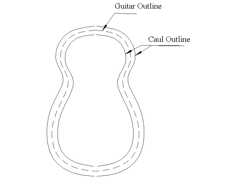

You might want to consider making a clamping caul for your tops and backs. I made one about 1 1/2 in. wide and about 1/4 larger than the guitar outline, out of 1/4 in. tempered hardboard. Didn't do this on the first back I glued, and found that the little plastic tips squeezed out a bit of oily residue. Not bad, but left noticible stains on the EIR. Fourtunately they seem to have sanded out! The caul will distribute the clamping pressure also.

[QUOTE=Mark Tripp] Steve:
-Mark
Hey Mark, do you mean basically making a doughnut of hardboard, 1-1/2" wide, shaped like the guitar such that the outer shape overhangs the guitar somewhat? I did a quick pic. Is this correct?
Thanks for the suggestion, Steve

Steve:
Exactly right!
